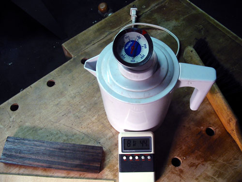

I did monitor the temp of my rival hot pot but did not measure the amount of water I used. I just added water until it was just a little over the top of the glue.
My shop was not quite as warm as the photo indicates there was a portable light shining on the thermometer. It was actually about 77 F. and as you can see the HHG was about 140ish.

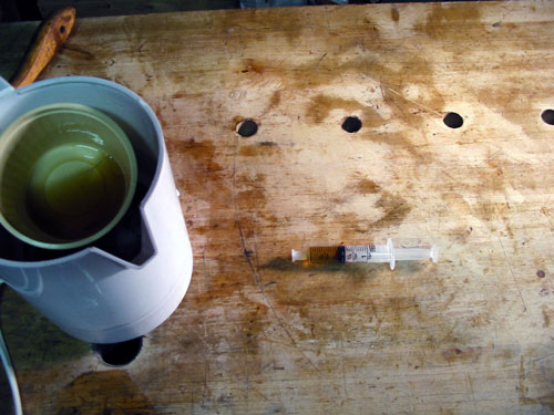

The mixed glue looked like this and I used an oral syringe to dispense the glue with.

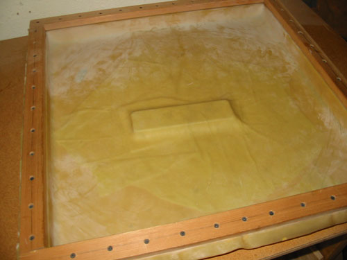

I then took my HHG syringe from the hot pot and applied a generous amount of glue to the bridge blank. I made no special effort to work extra fast nor did I heat the bridge blank. Then I placed the assembly in my vaccum frame, I use vacuum to clamp my bridges on so it was representative to me.
I left the assembly under pressure for 30 minutes and removed it form the vacuum press and set it aside.

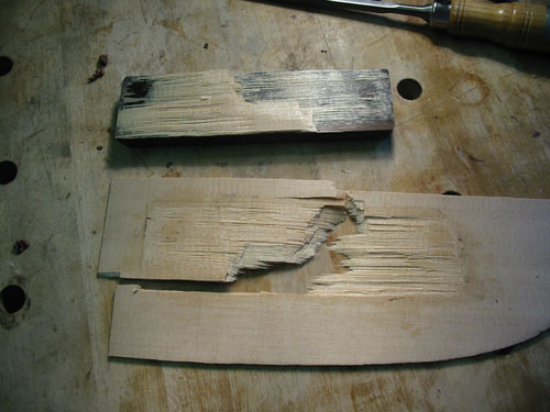

I then ripped it apart 12 hours later and this is what I got.
I'll repeat this test a few times to make sure I actually have a process.

Paul,I think that as long as you get wood failure your joint is sound. It doesn't really matter how many pounds it takes to make it fail as the wood is the weak link in the chain. Also I noticed in JJ's post in the fish glue thread that he also use a sizing coat.
So I think it would be great if you did the test also. More data the better. But you won't be able to tell which way is better if the wood fails on both.Jim_W38949.0319328704

     If you look at the structural damage from the failure test one can see about 90% of the bond exceeded the wood strength. Obviously the sizing worked! If this is worse than a non-sized bond remains to be shown, but I doubt it.
    I would be very happy with that kind of strength. The explaination that the thinned HHG absorbs deeper is plausible if not very likely.
